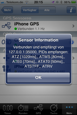

Sensor Information gives the following output:
- IMG_0103.PNG (116.83 KiB) Viewed 8409 times

LapTimer shows all requests it has sent to the OBD dongle here (in case there is a duration in brackets added, LapTimer got a reply too). Strictly speaking, these are not only OBD PIDs, but some control sequences too. Your pictures show that only control sequences were sent, LapTimer did not request a PID at all. This is most probably, due to some non standard behavior in replies from the dongle.
