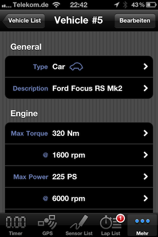

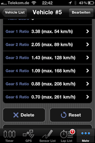

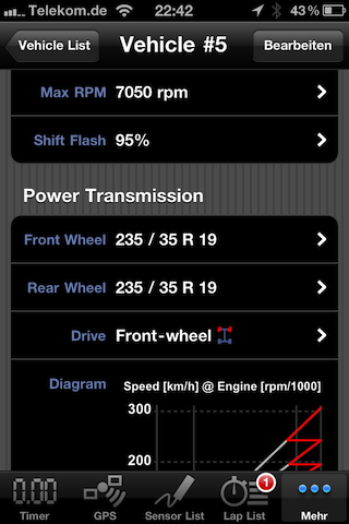

I have a similar question. I have focus RS MK2 and its 6th gear has ratio of 0,7, Final Drive ratio is 4 and it uses 235/35/R19 wheels. The calculated max speed for 6th gear is 216 km/h and real max speed is 263 (as provoided at ford). The max RPM is 7050 but it works for few seconds only the it falls to 6500 RPM. Should I change the drive ratio to 3.3 or similar to have max speeds closer to reality and have right shifting info concerning the gears ?
regards
K
Posts: 10675
Re: Gear max speed calculations
This should be a standard one. I believe one of your values is wrong, please check:
Please check your technical data. It says that the engine develops 225 PS at 6000 rpm. This means that the power decreases at higher rpms due to reduced torque. The 7050 is a max rpm the engine can reach, however, it is better to shift earlier.

Max RPM and gear ratios are provided as on your screenshots.

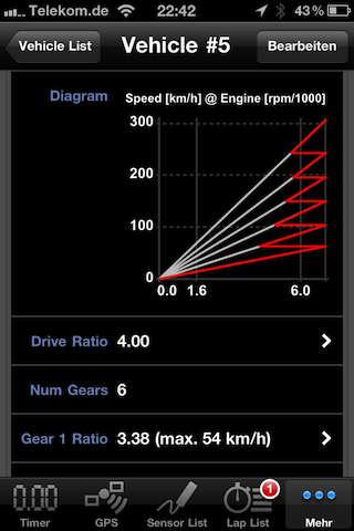

Speeds in the Gear Ratio rows are the speeds achieved at max power. You can read out all variations from the diagram above. Calculating speed at max rpm is possible but is again a calculation that will not fit every situation (e.g. in 6th gear). There are all kinds of max power / max torque / ratio / gear combinations in the market, you always need to read the story behind the numbers. With a OBD connected, max power rpm is were green changes to red. Red stops at max rpm. So while driving fast, you will be sometimes below this green / red area and sometimes above (up to the end of red).
