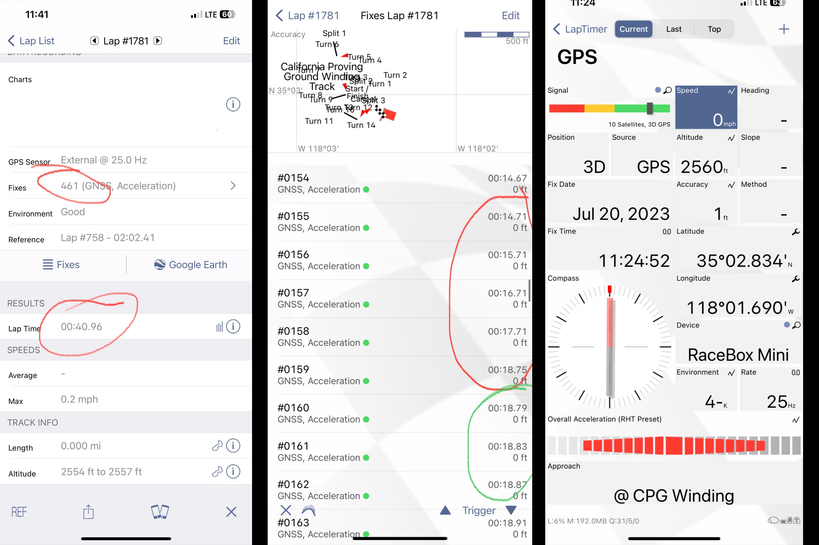

With the newest version 24.8.2 on iOS, I’m having some issues with the new RaceBox Mini S. Looks like the data rate is still mostly 1Hz and occasionally record at true 25Hz.
On a manually timed 40 sec data, I’m only getting 461 fixes
With my old 10hz gps in comparison, this doesn’t seem to be an issue. I’m getting pretty much all the fixes at 10Hz.
Re: RaceBox Mini

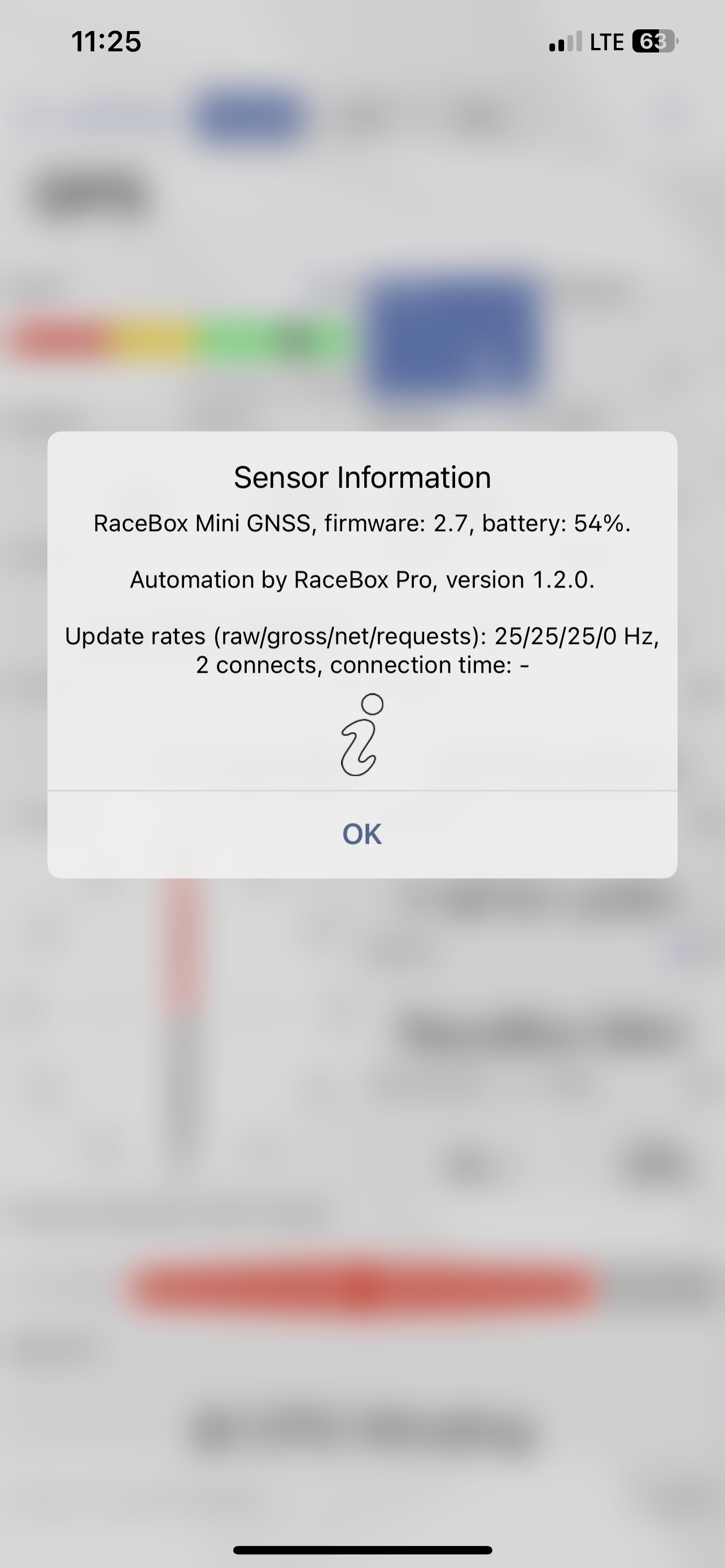

This looks like the Mini disconnects from time to time. In situations like this, LapTimer will fall back to the internal sensor. As a result you will find a number of fixes anywhere between 1 and 25 Hz - depending on connection times. Please start with testing the connection: start LapTimer and let it connect to the Mini. Make sure it is getting to 25 Hz. Let it go for 15 minutes with LapTimer active. Goto Administration ‣ Sensor List and tap the Mini. Sensor details will show the number of connects that occurred. Should be 1 or 2 for 15 minutes.

With the Mini connected, goto Sensor List and bring up Sensor Details. Which script version number is shown?
vafan13
Posts: 24
Joined: Sat Sep 17, 2022 10:55 pm
Re: RaceBox Mini
Post by vafan13 »
Harry wrote: Mon Sep 18, 2023 8:32 am With the Mini connected, goto Sensor List and bring up Sensor Details. Which script version number is shown?
It says "automation by Racebox Pro v1.2.0"
