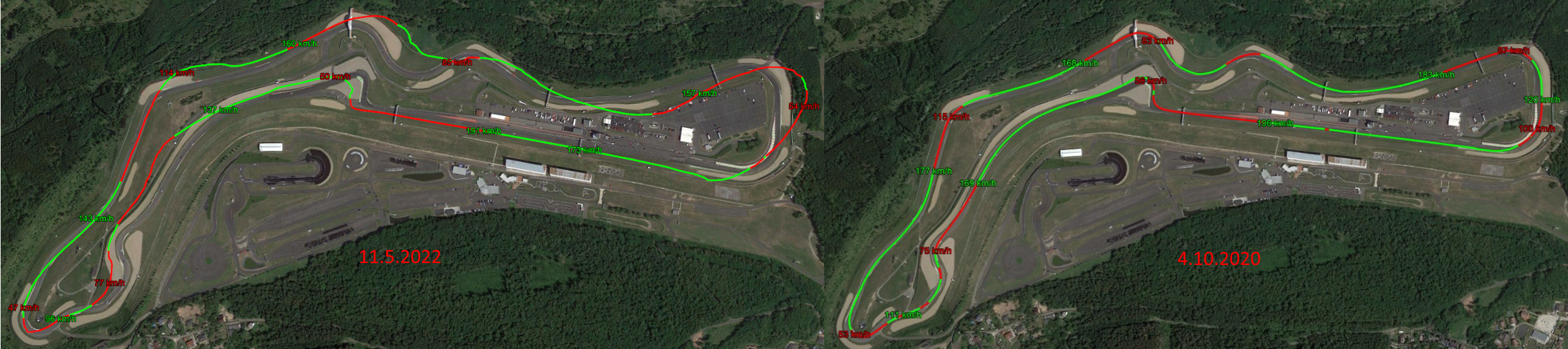

Hi, I have a strange problem. As you may see in the picture. Same track, same XGPS160 (same firmware) only "2" years of difference and weather. 2 years ago was around 15° and today almost 35°. It´s not a problem of the phone, because I had simultaneously connected second phone to the GPS with TrackAddict app, and there is the same result.
It´s the problem with GPS shift, or something else (f.e. 2 connected phones at the same time)? I´m just asking to prevent it in the future.

That’s the so called “GPS shift”. It varies slowly but all the time. Results for the next track day may be better again - or shifted to a different position. It depends on the current satellite constellation and atmospheric disturbances.
RTK / GBAS systems eliminate that by using a reference station.
LapTimer has another feature to optimize it: select the lap from Lap List, follow Data Recordings / Fixes, select Remove GPS Shift from the second icon in the bottom.
LapTimer will apply a translation to all positions recorded so the overall difference between line driven and POIs is minimized.

I´ve already tried that feature to fix GPS shift, and this is result. I think problem was the second phone connected to the GPS itself. Because first 2 laps are nice and clean, after second lap I connected second phone and then it becomes messy to all remaining laps. XGPS can connect 5 devices at the same time, but I never tried it on the track. Maybe this was the problem

Positions will not be different when a second phone is connected. Definitively not. That's GPS Shift.

if its GPS shift how is possible to have first few laps in the session nice, and from the third it was like this. Only difference was the second phone. GPS was mounted on dashboard under front windscreen

The other difference is the time elapsed between the sessions. The satellite constellation changes all the time and atmospheric disturbances too.
The other reason I'm sure is that the position is calculated by the GPS chip once. There is neither a reason or the processing capacity to do position calculation twice (or five times). Instead the initial processing step will create the full fix information and a later step will distribute "copies" of that fix to the various consumers / clients.
