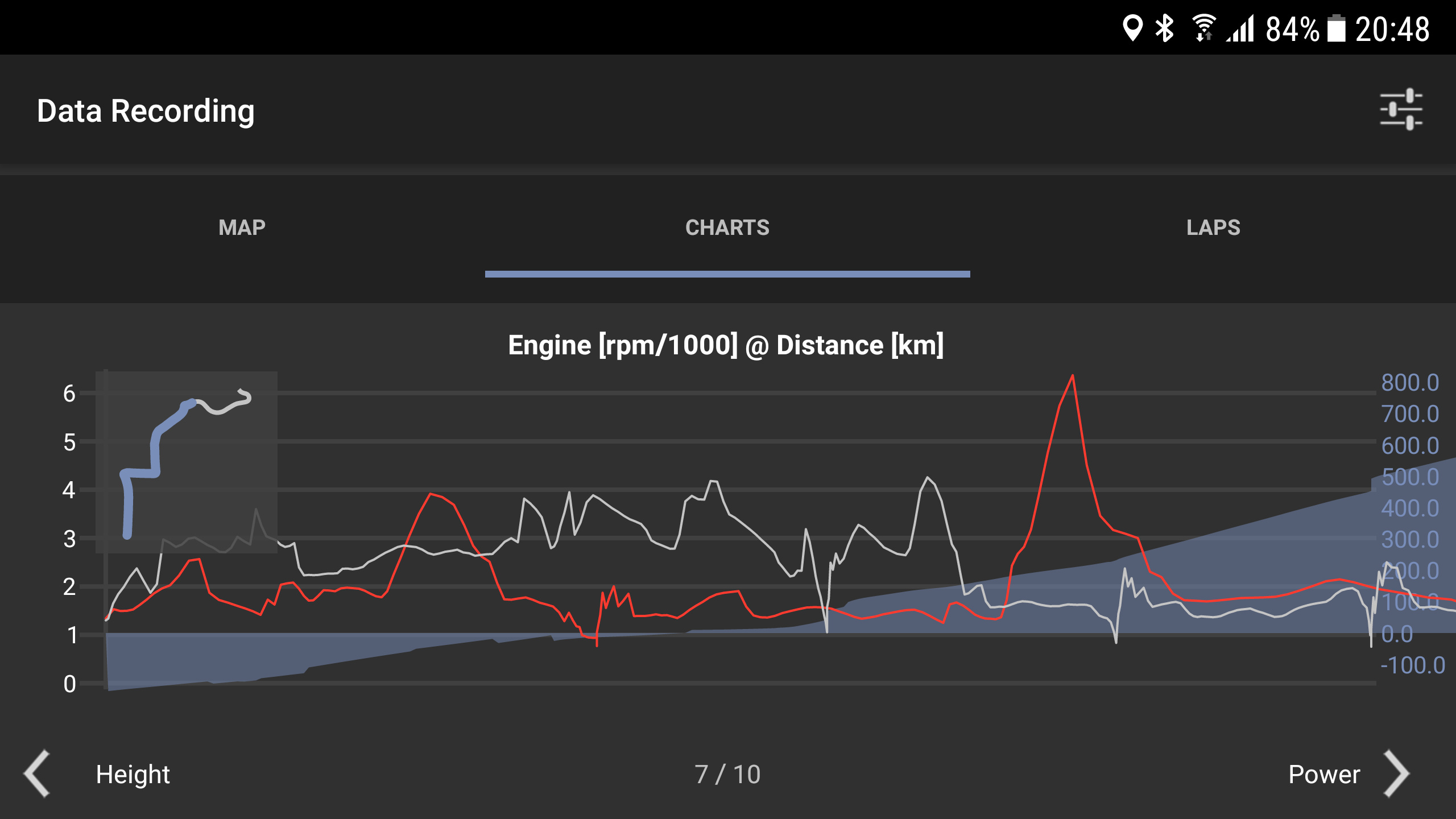

Hi Harry, just a thought. It is possible that it depends on the version of Android? Because usually actually use a Galaxy S9+ with Android 10. Today I tried it on my older Galaxy S6 with older Android 7 and RPM was smooth like.... I have also iPhone 6S but without HLT and I don't have wifi OBD, so I can't try it on it.

I'm sending printscreen from Android 7. It looks much better. I also tried other apps like OBDlink or Torque. All 3 apps on Android 7 are smooth, on Android 10 in all 3 apps really bad

Hi Harry, just an another update. I tried it on my another phone Huawei P20lite with android 9, also smooth. So I presume, it will be a problem with Android 10 :(
