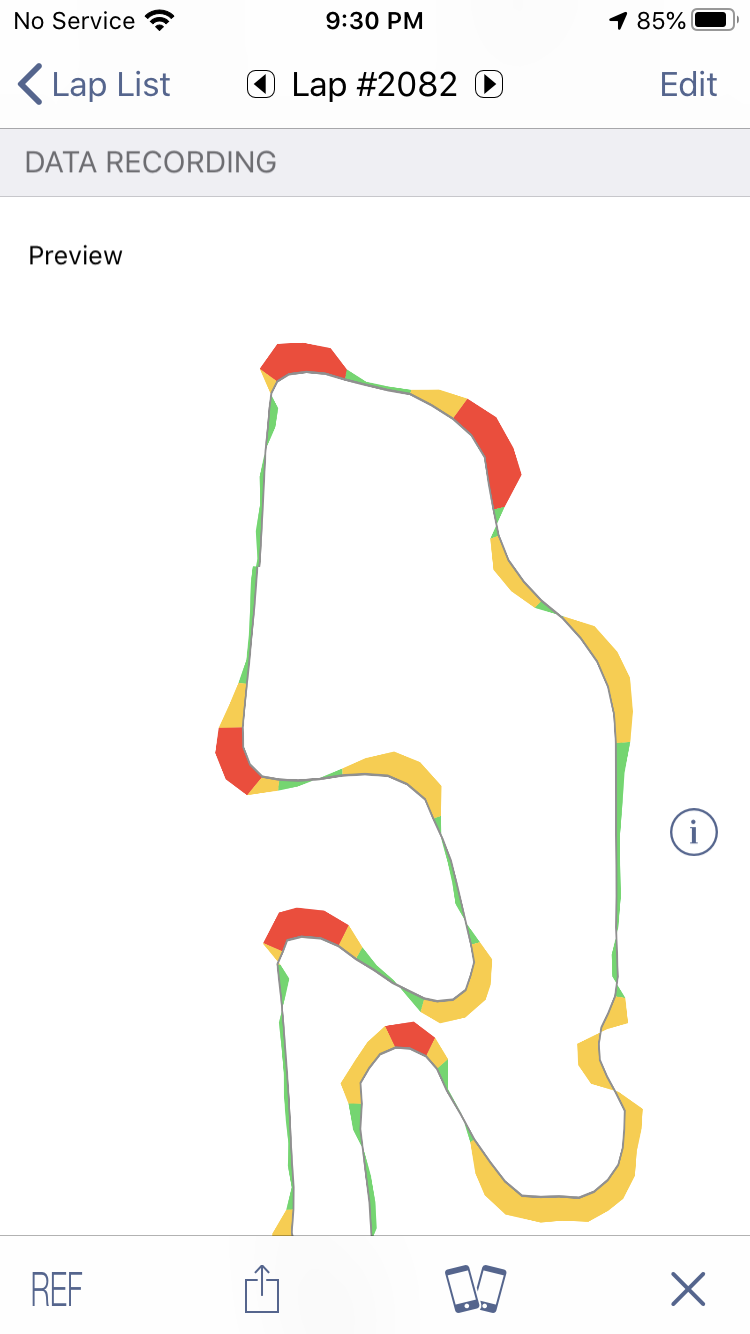

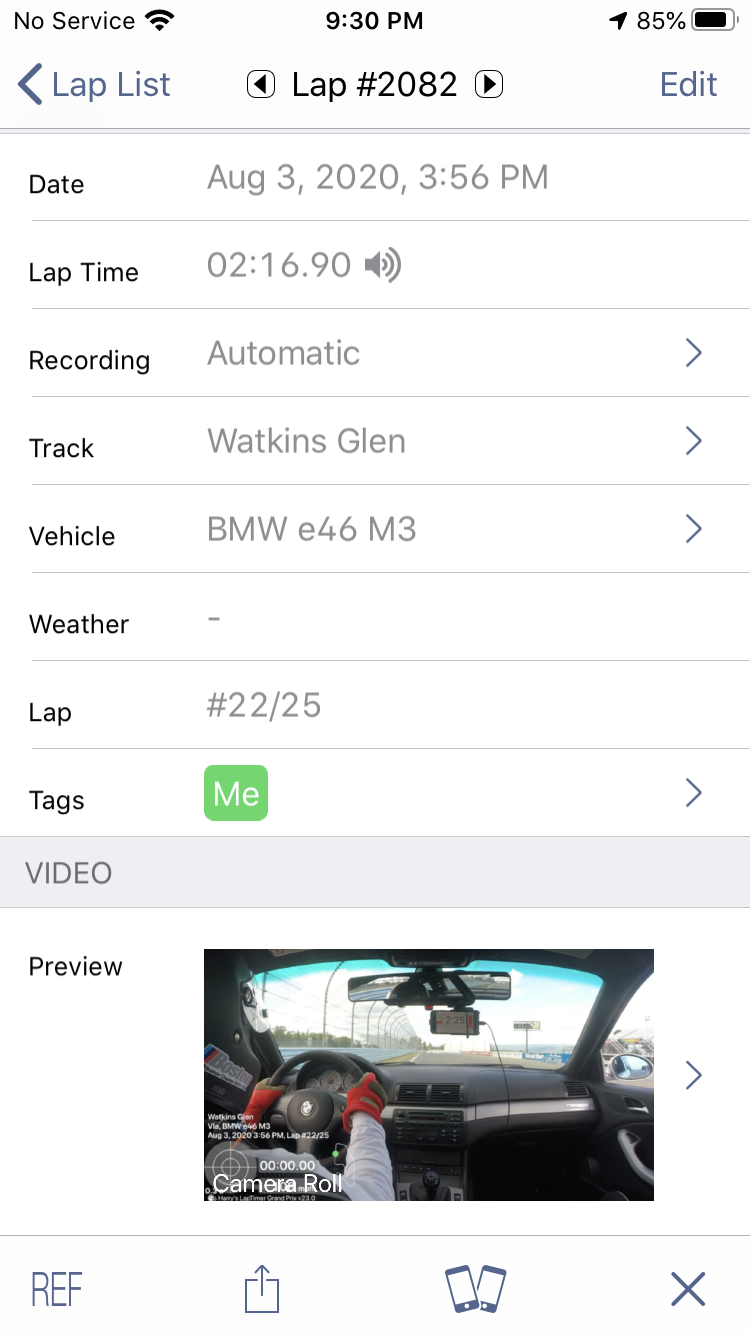

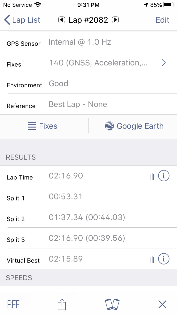

Thanks again for your help, here are the snapshots of my lap data.
- IMG_0030.PNG (196.78 KiB) Viewed 7414 times
- IMG_0029.PNG (180.45 KiB) Viewed 7414 times
- IMG_0028.PNG (659.28 KiB) Viewed 7414 times

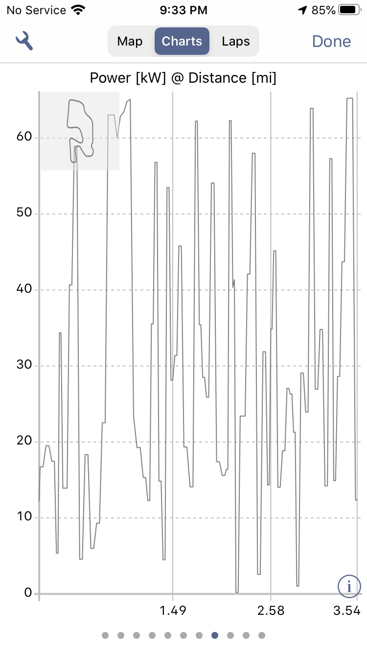

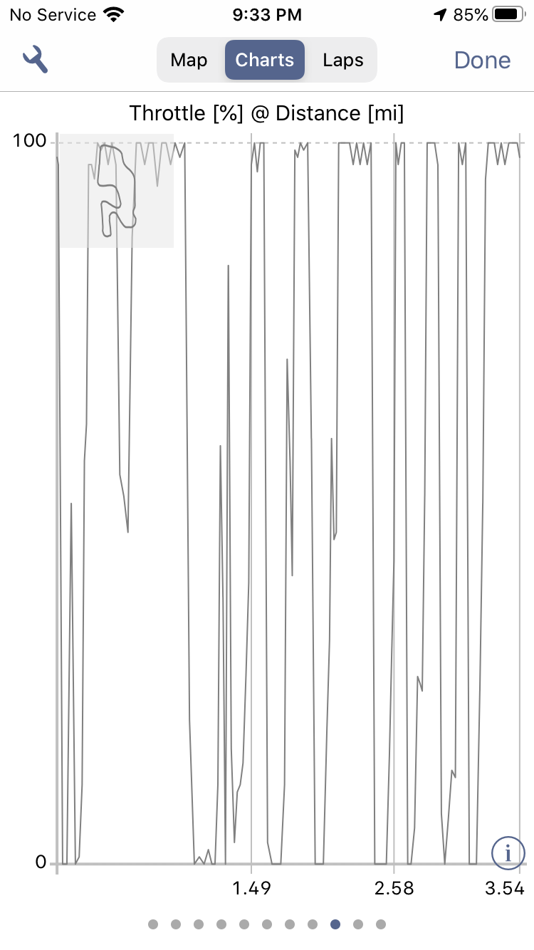

And here are some OBD data charts from the same lap
- IMG_0040.PNG (284.19 KiB) Viewed 7413 times
- IMG_0039.PNG (299.56 KiB) Viewed 7413 times
- IMG_0038.PNG (193.57 KiB) Viewed 7413 times
