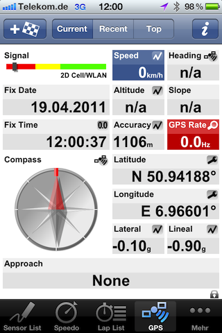

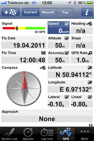

Posts: 10675
Re: Basic operation
Please let us check what you see exactly. The following pictures show the state LapTimer has location information from WLAN (first picture) and from GPS (second picture). LapTimer will not operate correctly with WLAN triangulation. This is the reason, only GPS fixes are counted into update rates. On the other hand, WLAN positions are used by Google Maps. The question is: do you have WLAN position but no GPS position?
Image Image
