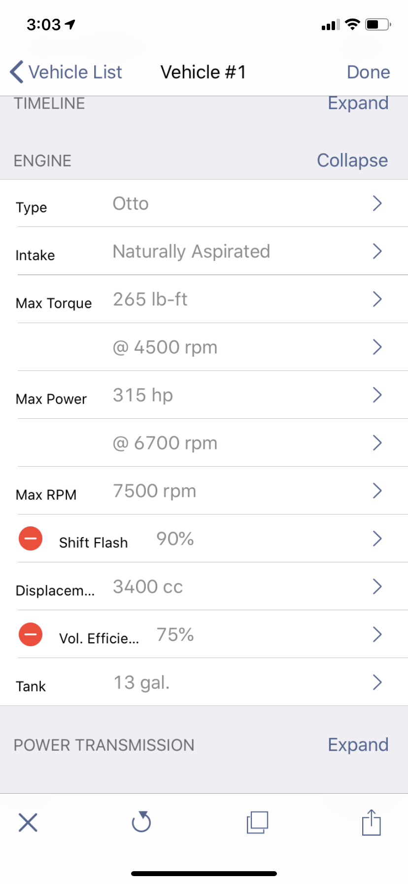

(2) I've attached a screen shot of my engine settings, they are per the Porsche specs for the car. Also below is a YouTube link to a track video... Right at the beginning on the straightaway, you can see the RPM display go up to about 6400, and the tach shows it deep in the red, even though the Max RPM is set at 7500. As I slow down you can see that the redline on the tach starts at 5000, not 7500.

The car data looks sound. I have tested the rpm settings for an overlay and they look fine. Can you please check on duplicate car definitions? See Administration ‣ Vehicle List. Maybe you have several Boxsters defined and reference the wrong one? In addition, please check the result using the real time overlay (Play). In case the video is overlaid already, gauges display will not change when vehicle details are adjusted.

I just have one car on the Vehicle list. BUT, I just took an old lap, reverted to the original video and re-exported with a new overlay based on today's settings adjustments, and NOW that tachometer looks correct - redline is way up at 4:30 or 5:00 o'clock on the dial which is about 7500 RPM. I did make some small adjustments today on the engine HP & Torque values to make them match the factory spec, but they were small adjustments. But it does seem to be correct now, I will have to try it out with some new laps at my next track day. Thanks for your help!

You can re-overlay all existing recordings. The new settings will be applied during overlay, not while recording.
