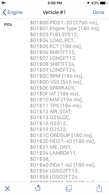

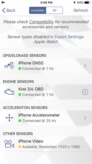

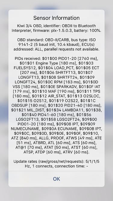

I checked the OBD rate and it appears to be updating at 1Hz. Is this the expected rate?
Blipping the throttle, I noticed how the data reacted/updated about a second later on the real-time screen; that's similar to the delay I see when I overlaid the recorded data onto the videos. Is there nothing else that can be done to get a faster data rate from OBD?
I've attached a couple phone screenshots I took.
Thank you again,
Fred
Re: Help a Newbie Out
That’s a pre-CAN bus protocol, you will get one or two Hz with them, not more. The on-screen delay is due to runtime effects, it simply takes that long for the data from a change in reality until it arrives in LapTimer. In general, using OBD is not too much fun for pre-CAN cars. :-(

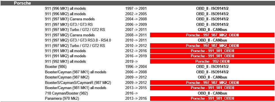

Wow, I wasn't expecting that answer seeing my Boxster is a 2006. I thought all Porsche's 2003 and newer all used CAN Bus, which sounds like that is partially true, but they didn't use CAN Bus protocol on the OBD connector. I found this info on the AIM website which confirms Porsche didn't start using the CAN Bus protocol on the Boxster/Cayman until the 2009 model year. Looks like I'll skip capturing slow OBD data for my car. :( I don't see any reason/benefit to continue to capture OBD data during laps when the data's so slow.

Good point, but the protocol negotiated is ISO4141-2 according to the snapshot...

Harry, see my new edited response above. You are correct. Porsche doesn't use CAN Bus Protocol at the OBD connector in the Boxster/Cayman until 2009. Based on that, I will stop using the OBD to capture data during laps, too slow to be useful.
