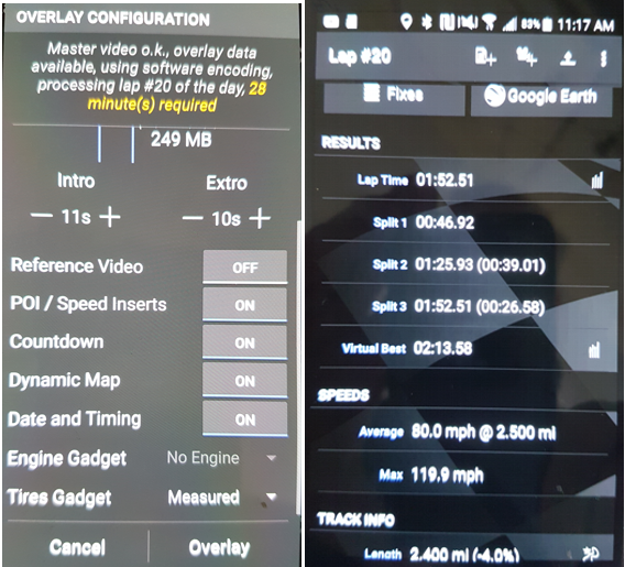

Please post a screenshot of the lower part of the Overlay Configuration dialog.
swbca3691
Posts: 64
Joined: Wed Sep 02, 2015 10:57 pm
Location: Edina, MN
Re: No lap times displayed in overlay at Finish line
Post by swbca3691 »
Two Screens
That's looking o.k. I will try to reproduce this for the upcoming LapTimer v24.
