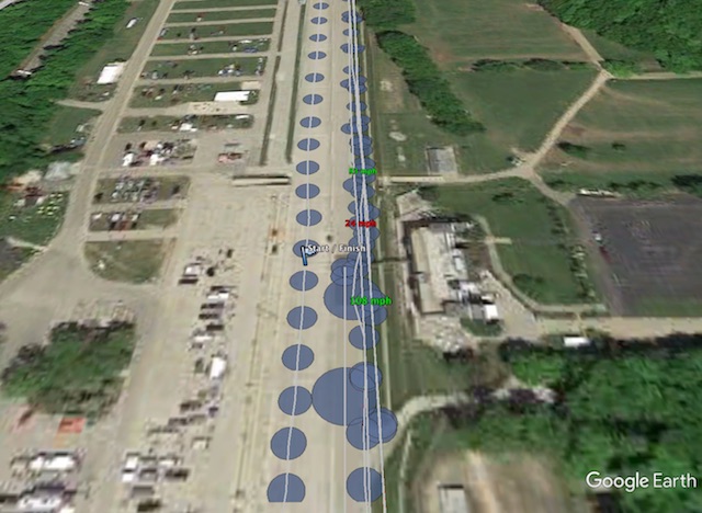

This looks like an issue with the track set (and accurate GPSes). In the attachment below, you can see the start / finish trigger is places in the pits, not on the track. For receivers with high accuracy, the corridor used for trigger detection is narrower than for low accuracies (like the internal GPS). This means missing trigger precision is not compensated by a larger corridor... In this case, you simply passed the trigger without an action.
We will revisit the track set definition and Monika will come back here once it is adjusted (and the track set can be reloaded).
For your existing recordings, please enlarge the Wide Detection Corridor to e.g. 100m (instead of 40) in Expert Settings. Select one of the multi laps in Lap List and tap Recalculate ‣ Verify Lap. This will run a re-detection. Agree to delete the old (multi) lap finally so these recordings do not disturb your list consistency.

both Brainerd configurations are now updated with start/finish line in a better position on the track.
Please update your loaded tracks:
Admin -> Add-ons, update the list with button top right.
Afterwards search e.g. "Brain" and reload the track you use.
- Monika
