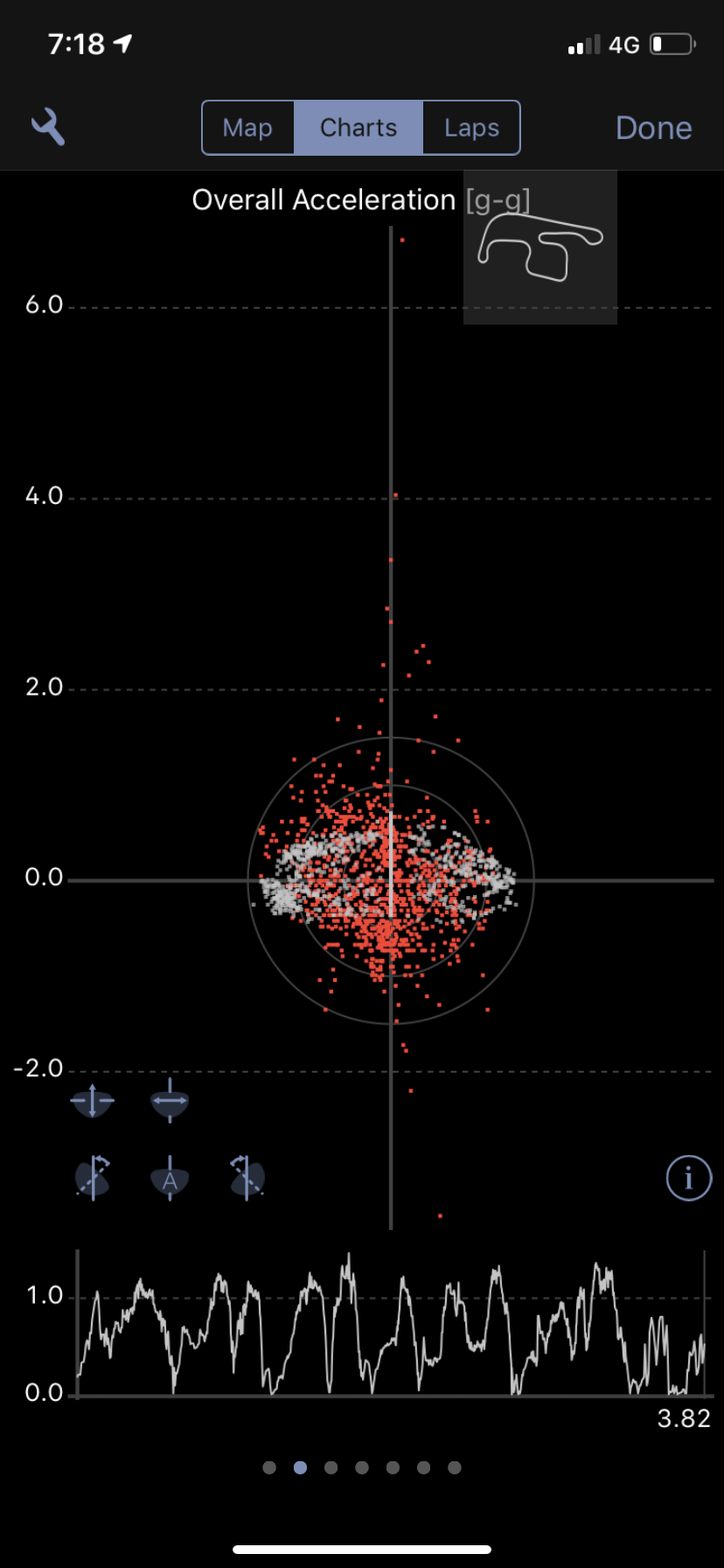

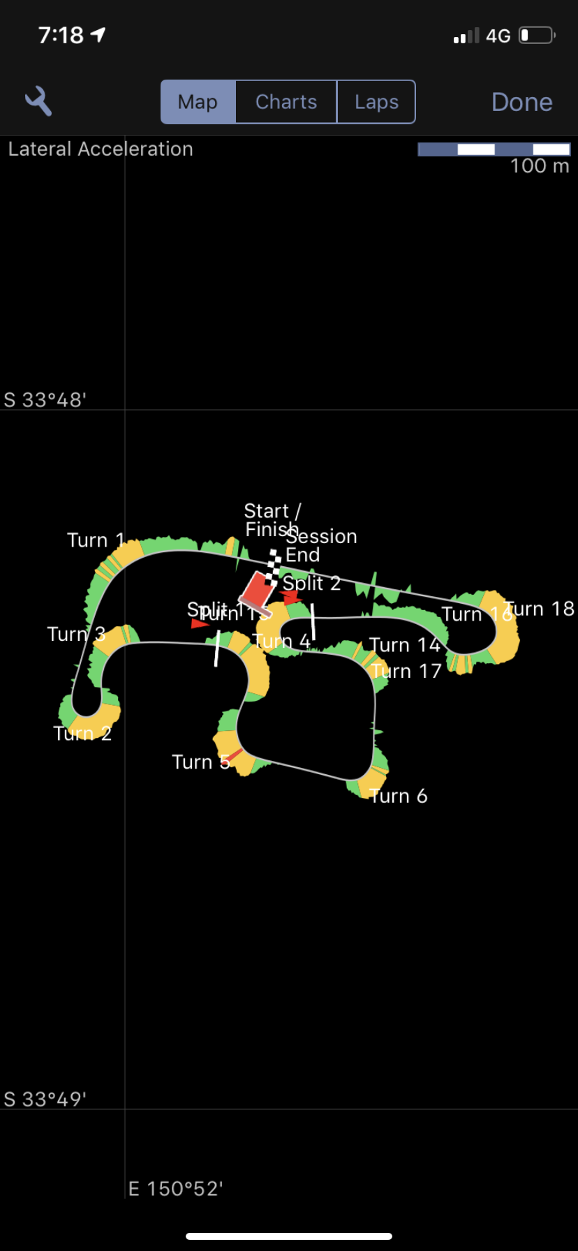

I have an iPhone 8 running Harry’s GP edition version 23.0 with my track bike and external GPS Dual XGPS160.
I’ve been using the app for almost two years (love it) but recently I realized the lateral acceleration recorded is crazy, very erratic showing lateral acceleration of over 3g, any idea what may be the problem?
Thanks .... love the app btw :)
Below screenshots of how the graphs look
Re: Lateral Acceleration Not Corrrect
Lateral acceleration for motorbikes is actually calculated from downforce. This is necessary because lateral acceleration measurements will deliver around zero due to the lean. The disadvantage from this calculation is that it is very sensible to wrong mounting angles. See illustration #4 in Quick Reference. So the answer is “please check angles of your mount”.
In case this doesn’t work, please use. Calculation from GPS measurements: Lap List ‣ your lap ‣ Positions ‣ Recalculate Icon ‣ Acceleration.

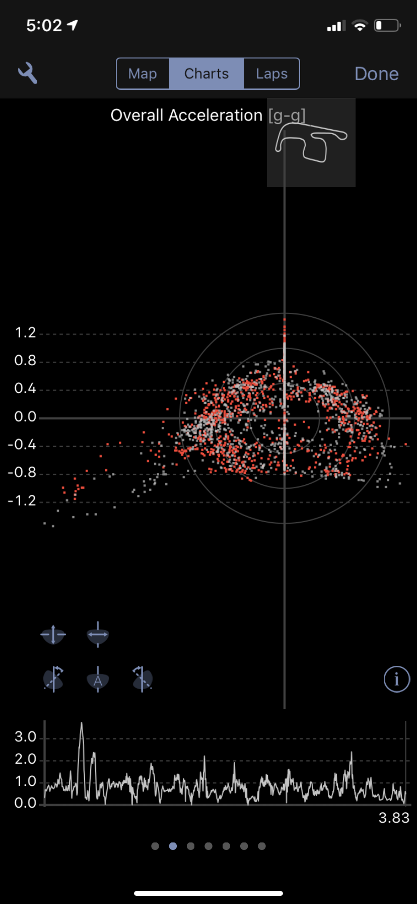

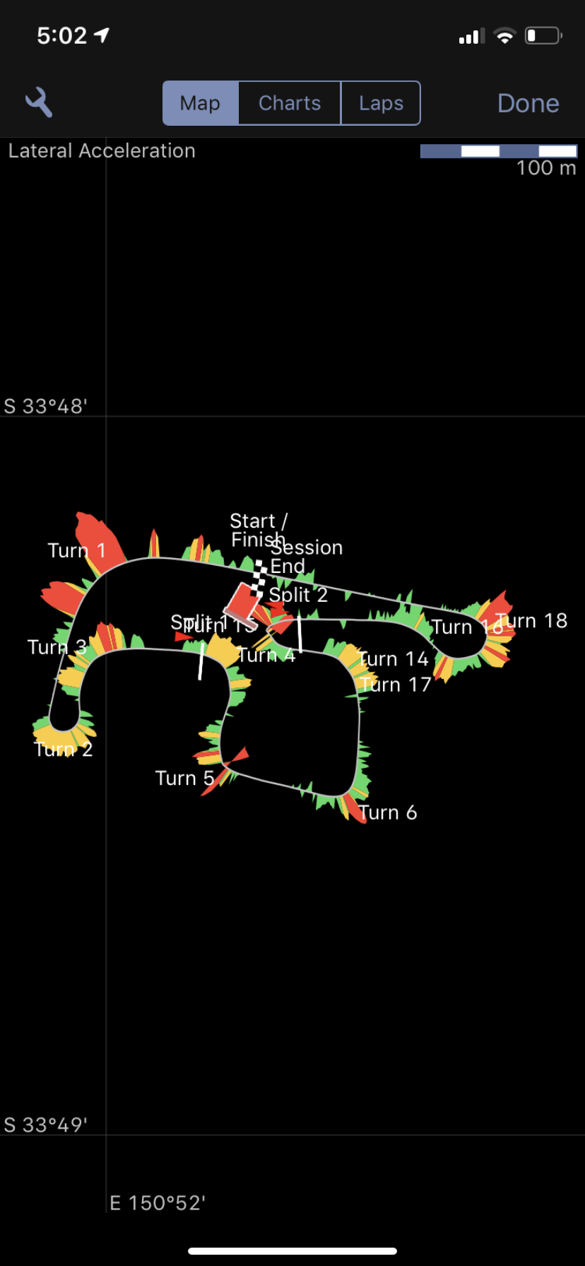

I was having a look to laps recorded last year and they look pretty good, the only difference is that I used to record the lap with my phone’s front camera, any idea why it was working well back then?
The red dots are my new reference lap taken last week (all erratic) while the white dots are almost 1 year ago.
Thanks!!
When recording a video, a different orientation is used. This means a different rotation matrix is applied. See www.gps-laptimer.de/documentation for the document "Acceleration Handling".
