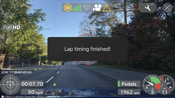

When trying to record, Laptimer is only very erratically started by Start/Stop triggers, usually not at all. It is not stopped by triggers. When manually stopping the recording, the time numbers are nonsense. For example, I started recording manually about 300m before the S/F. Timing did not start, but I drove past and continued around the "track". I stopped timing after about 90 seconds:
but the time recorded was only 7.7secs. These images were screenshot withing about 20 seconds of each other.

There is possibly some issue with the direction setting on custom tracks. I am 100%, definitely, absolutely setting a direction on these trigger POIs. I never skip this step. But I wonder if this custom set direction is being ignored by the app for non certified tracks? Or perhaps when starting recording Manually?
Between the above pictures, the start finish line was actually crossed (it's the pedestrian crossing visible in the first one), but the direction is set to be 180° to the direction I was travelling in these images. No lap was triggered, but the time of 7.7 seconds might be about right for the time since passing the S/F, - in the opposite direction. This kind of matches my impression that some of the false trigger issues I have been getting seem to be ignoring the direction when the GPS fixes wander around in bad GPS conditions.
