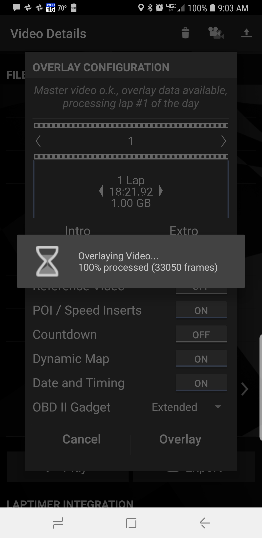

I was at Pitt International this weekend and am trying to export my videos. I have the Grand Prix edition v21.2 on Samsung Note 8. I manually started video recording in the pits, and manually stopped them. The video and telemetry looks good when viewing from HLT. When I press the Export button, the processing gets to 100% but won't complete (see attached image). I even let it run over night just to be sure it had enough time to finish. I tried processing a different session, that did be same thing. In researching this, I saw where turning off the reference video might help, but I couldn't find the Overlay Configuration screen. So I need help with that too. I closed all programs, powered the phone down and restarted, didn't help.

The 100% issue is either a corruption of the video's end (occurs e.g. when memory is short), or some coding incompatibility. To work around, please switch to Software Encoding in Expert Settings and try again.
