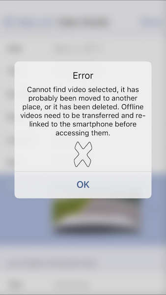

Any tricks to getting Lap Timer to recognize the videos in the iPhone Camera Roll? If I transfer with the SD adapter, I can play them natively on the iPhone and Lap Timer sees them in the Camera Roll.
When I select a video from the Camera Roll, I receive the following error:
Video Play Erro
Video Play Erro
I tried reseting Lap Timer's permissions to the Camera Roll by revoking / reinstating. Also confirmed I can export an overlay to the Camera Roll using laps from a few months ago.

Re: Hero 3+ and Itunes 12.7
Like for any transfer of video from the outside, you need to Re-Link the placeholder (OFFLINE) to the video transferred. Select the lap, press the row showing the OFFLINE video, press Re-Link and select the video (from Camera Roll) to close the loop.
