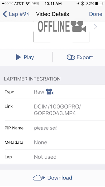

Thanks Harry. I apologize if I have missed something obvious, but I don't have an option to re-link the video at the bottom of the screen:
No re-link option
No re-link option

Re: Re-linking GoPro videos
The Re-Link button is shown in the place you see a Download button in your snapshot above. It looks like you have replaced the original multicam link by a link to a remote video (starting with http://). For this link type, Re-Link is not available. Instead of analyzing what exactly has been done (I believe I know) or what the backgrounds is (I'm sure I know), it is probably best to start over. Goto your lap (Lap List) and select Edit / Add Video. Select the video transferred and select the end of the lap (see instructions in the Sync dialog). In case you have the other video (OFFLINE) still associated, remove the entry.
