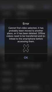

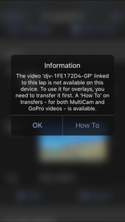

Today I used the latest version of Harry's for the first time with an external GoPro. When I try and play back that video it will show the GoPro portion of that video as "offline." That's fine. Harry's make it very clear you need to transfer the file to Harry's and link it.
The iPhone camera version version is fine and the video plays fine if I "edit" and "delete" the GoPro camera/external cam. It can be exported, the overlay's work, etc., all.

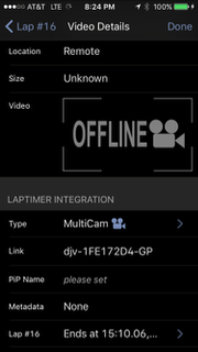

The problem here is the video file it wants for the GoPro Extra Cam:
"djv-xxxxxxxx-GP" isn't how the GoPro video files are named. The GoPro video for that session was actually 2 videos because I hit the 4gig Go Pro limit and it rolled over.
I'm missing something here, even after reading the "How To." : :oops:
Harry's implies(?) it made smaller, lap, based video files named what it "djv-xxxxxxxx-GP" on the GoPro, but that's not the case. The GoPro video is one big gopro* video like it always is, and for this session, 2 of them because of the 4 gig limit.
Note: I am not asking how to transfer files to a place Harry's can see them. I understand that very clearly. I am asking how to get Harry's this exact lap it wants with that file name? Surely Harry's doesn't expect me to edit the GoPro video and export as that specific name?

The name shown for the external cam link in LapTimer is a kind of placeholder and does specify a filename like used by action cams. LapTimer does not get information on the real name from any cam currently, so this is an "open" link initially. To associate such an open link with a real video file transferred, please use the Re-Link function available in Video Details. It removes the placeholder and replaces it by the URL / filename selected. This operation preserves any sync information, so video and lap data are in sync from the beginning.
LapTimer has no multi file support for session videos. In case the laps to be overlaid are covered by the first video file, you can re-link this file and things will be fine. In case laps to be overlaid are in further files, you need to join the videos on a desktop first. The alternative is to add this fragments to laps manually and set the sync point manually too. Laps crossing fragments cannot be overlaid using this approach.
