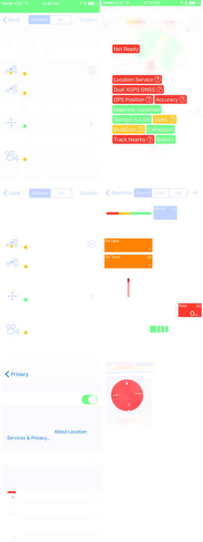

Thank you for any help. I am unable to get external GPS sensor data in LapTimer Grand Prix.
Here is what I am using:
* iPhone SE iOS 9.3.1 (13E238)
* Dual XGPS150A firmware 1.3.2
* Harry's LapTimer Grand Prix 20.0.3
What works
* Successfully connect iPhone to Dual XGPS via bluetooth
* Can see Dual XGPS GNSS as Available - Yellow in LapTimer sensor list
* GPS light on Dual XGPS is on/solid, meaning it has satellite to fix position
What doesn't work/errors
* Dual XGPS GNSS is always "Available", not "Connected"
* No data available in Real-Time GPS screen (Signal, speed, heading, long/lat)
* LapTimer status Red items are:
* - Location Services ?
* - Dual XGPS GNSS ?
* - GPS Position ?
* - Accuracy ?
* Steps that crash LapTimer every time
* - On the RealTime menu screen, clicking Satellites
* - After clicking GPS in the Realtime menu screen, clicking the signal strength bar (red/yellow/green)
Confirmed iPhone settings
* Privacy -> Location Services -> ON
* Privacy -> Location Services -> LapTimer -> While Using
Other testing
* Successfully used same Dual XGPS150A device on a friend's iPhone 6s v9.3.1 running LapTimer v19.0.30 - saw multiple satellites and successful long/lat.
* Attempted to use friend's Dual XGPS160 with my iPhone SE, same problem --> Bluetooth Connection but no GPS data
* Factory reset iPhone SE and deleted all data, loaded LapTimer and connected to XGPS150A via bluetooth. Same result, no sat data in LapTimer
Screenshots attached
Thank you for any help/suggestions!

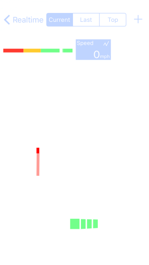

Thank you for the quick reply. Use Accessories = ON. XGPS150A switch in Apple position (farthest away from USB jack). Closed all apps on iPhone, unpaired and paired Dual XGPS, then launched LapTimer, same result.
When turning off Accessories, I do get a GPS fix, but it does not go over 1 Hz (see screenshot attached).
I have downloaded the GPS Buddy. Are there any specific steps that I could capture that would be helpful?
Thank you!
Thank you!
- Realtime screen showing 1 Hz GPS
- IMG_2579.PNG (45.9 KiB) Viewed 4246 times
