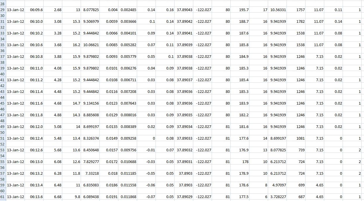

Why is there an empty row between every data point on the .csv file? It seems like the empty row is the lost 0.1 second of data?
It is also interesting that video generated off of the iphone with your software does not seem to skip every other 0.1 seconds. Perhaps there is an issue with the exporting of data to .csv format and we are missing one out of every 2 data points somehow?
I've attached a screen print of my .csv. Notice the space between each line

- screen shot of my .csv trackvision export. Note the space between each line. Data points are only every 0.2 seconds, not every 0.1

Hi Joe,
Starting with the skipped line - this is about different line breaks on different operating systems. Older LapTimer versions added a CR and a LF character to the end of each line. I believe starting with 14.4 (didn't check, need to search the history) only a LF is added. Good editors are able to handle all kinds of line break combinations, your Excel import obviously converted the CR and the LF in a line break each resulting in the empty lines. For Track vision import, either it is able handle different line breaks, or you need to convert it to your platform's (Windows, I assume) standard first. Please check your LapTimer version too, 14.4 has just been released. As long as values are not falling down to 0 every seconds data set, I assume this is not an issue at all and TrackVision skips this.
The main difference seems to be the 'update rate' of the export. As your GPS delivers 5Hz, LapTimer delivers a dataset every 0.2 seconds. For 1Hz devices (or the internal GPS), it will have one line each seconds. You said the RCPro delivers a row every 0.1s - this simply means it does 'a little bit' of interpolation during export already. Looking into the sample videos, it is obvious for me TrackVision does not apply interpolation. Although the overlays look o.k., they are bumpy compared to what LapTimer generates. Reason is that LapTimer calculates an interpolation for every frame - which is 30Hz for iPhone videos. So even adding a seconds line per data set is actually not really good, it would be best to have a lot more.
To work around this, you may consider the following: simply import data from LapTimer into excel. Interpolate the rows using some Excel macros yourself. For 0.1s is it pretty easy as you can use the empty rows and add "=AVERAGE(cell above; cell below)". This will work for numeric fields at least. In case you want a really great video, add 5 interpolation lines for each row (which is a little more tricky - send an email if you need assistance here). Finally, export the Excel to CSV again.
Hope that helps.
Hope that helps.

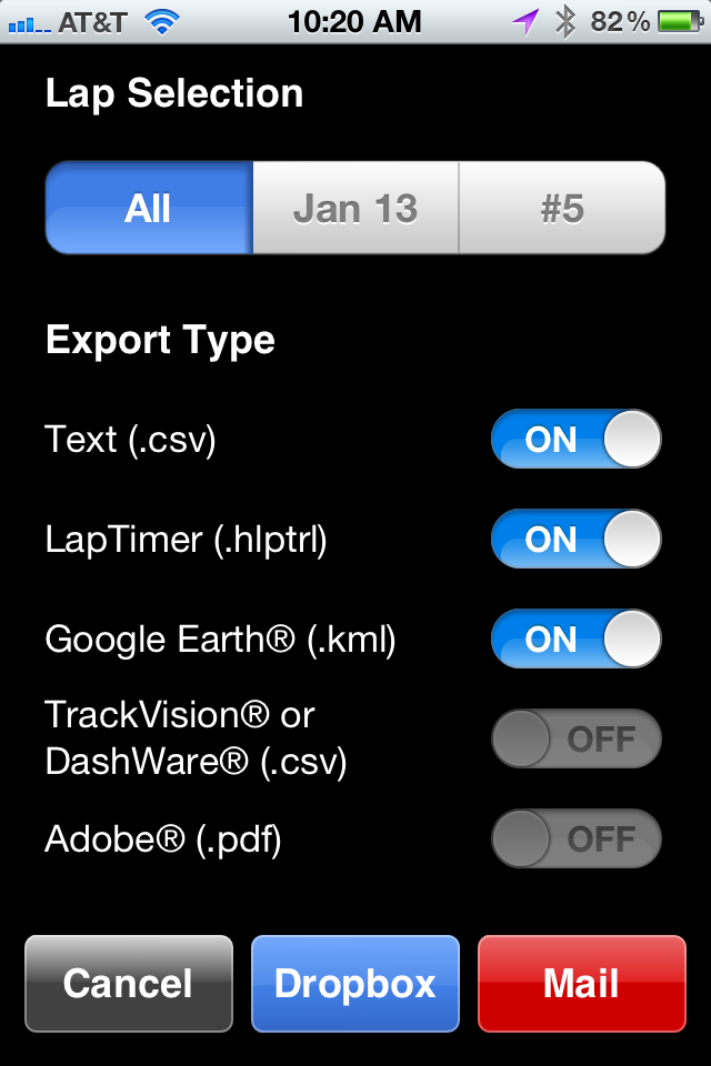

one last issue:
I can only export a trackvision/dashware .csv one lap at a time. Is there a way to export all laps to .csv? If I select all or entire day, the option for trackvision/dashware .csv export fades out and is no longer an option...
one last issue:
- trackvision/dashware export is unable to be activated
- photo.PNG (115.73 KiB) Viewed 16342 times
