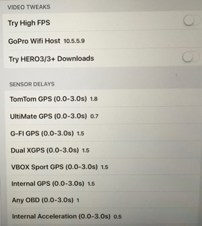

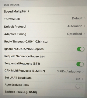

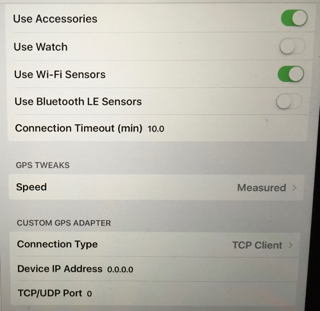

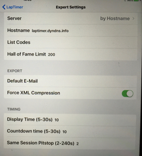

However while trying to set up the Kiwi 3, I reseted the expert setting along the way, and now HLT is not working with the WIFI ODB adaptor. It's connected and available under the sensor list as "KiwiWifI", but shows RED for ODB update rate. And I don't get the Coolant temp and gear position at all. I've tried resetting the Expert Settings to default but didn't work.
Below are the current Expert Settings. Can someone give my some tip on how the Expert Settings should be? The car is Porsche 997.1 C2S.

I cannot see anything wrong... Try power cycling everything (car, OBD, smartphone, app) and try again. In case it doesn't work, please follow instructions in viewtopic.php?f=39&t=1500 to send a log.
Re: Messed up expert settings...
One item maybe: in case you are sure your car has a modern CAN bus, CAN Multi Requests (ELM327) set to 3/adaptive is fine. In case you have an older bus protocol, you need to switch it to Off.

Harry wrote:One item maybe: in case you are sure your car has a modern CAN bus, CAN Multi Requests (ELM327) set to 3/adaptive is fine. In case you have an older bus protocol, you need to switch it to Off.
This was it! Got it working now. Thanks!
