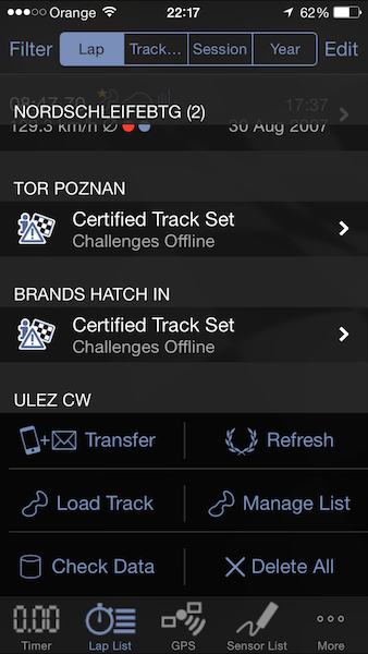

By the way, I've found another small bug during these tests. When you select POI set to download and the download fails because of network error, you get the error message, but the app still creates empty POI set in Lap List tab. You cannot remove it, even if you choose Edit. Take a look at the screen below - the empty track is ULEZ CW
