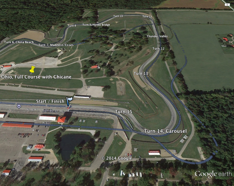

Done. i also sent a hlptrl where the track crossed over itself; is that a similar issue?
Re: Fixing Start/Stop pickup
No, that usually means bad GPS reception / accuracy. This by the way is the most frequent reason for missed triggers too... But I will check and let you know.
Well - that's a real GPS problem... From the snapshot you can see that at some point of the track GPS delivered a huge drift (constant translation to one direction). You need to contact the manufacturer of your GPS to clarify if this is a device fault or something that can happen due to some atmospheric disruption etc.
The stop/go trigger is placed correctly, so no need to adjust that track set from my point of view. With the above translation of position, it is obvious why LapTimer didn't split the laps... :-(

Wouldn't an atmospheric disruption show up as a drop in the number of satellites and/or a big change in the HDOP. That should be in the hlptrl file.
No, that's the problem. HDOP is a measure for the quality of the satellite geometry. The accuracy derived from it is the worst case assuming the signals received are correct. In case the signal is disturbed, accuracy is probably lower (worse) than reported. Looking into the sample, the blue bubbles (accuracy reported) for the drifted lap show the same size as those for the first lap... Keep in mind, GPS is assumed to report correctly (with accuracy) for 95% of the time only.
