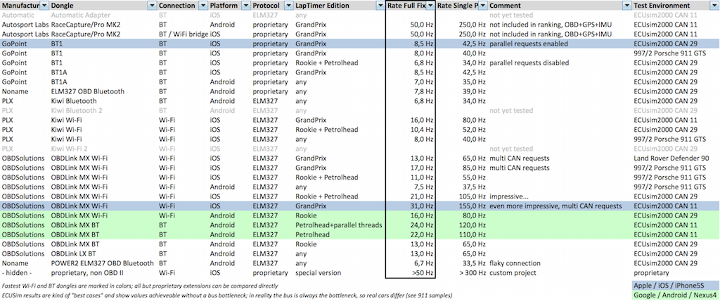

Just finished testing all the OBD II dongles I have available currently. Using the ECUsim2000 (which simulated a car on my desk), the results can be compared directly. For real cars, rates will differ depending on the bus protocol (CAN or older, the ECUsim has been configured to use CAN 29 bit/500kbps). The values shown can be considered to match late car models. Speed-wise, Bluetooth devices are slower than wifi dongles - they require less energy and are easier to handle on the other side. The fastest wifi dongle I tested is pretty old, it is a first generation Kiwi Wifi. I assume current wifi dongles can achieve even better values. I will constantly complete this list. In case you have a dongle available I'm missing here, please visit us in Cologne and we will test it.
[21st Mar 2014: initial list]
[30th May 2014: added OBDLink MX Wifi]
[2rd July 2014: added GoPoint BT1A and Porsche 911 GTS]
[15th July 2014: added OBDLink MX BT and OBDLink LX BT]
[18th March 2015: added variants with multi CAN requests plus RaceCapture/Pro MK2]

The TIFF doesn't show up; can this be fixed? Very interested to see the results before I buy an ODB dongle.
Re: [FAQ] OBD Benchmarks
Replaced it by a png version, hope it is readable. It is pretty small and fuzzy, I will update it with the next dongle tested.

What is the minimum speed for OBDII Bluetooth dongle? TorquePro says my noname dongle puts around 7PIDs/sec and LapTimer says it's too slow.
7 PIDs per second is roughly 1.2 Hz update rate. In case LapTimer reports 1 Hz (Sensor List) you can ignore the warning but need to expect some jumpy values for OBD. In case it is less (or zero), there is an additional problem. Please contact me by email in this case and add your system and car configuration.
