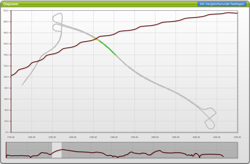

Now I'm getting weird results and massive "lag" in the velocity graph.
The faster the acceleration the bigger the lag.

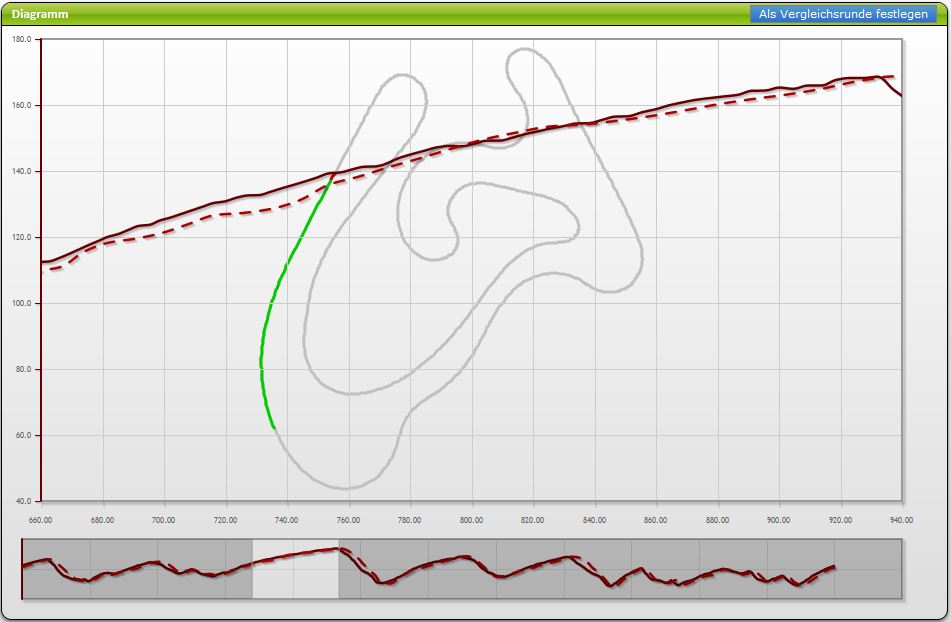

- A bit of lag on the race track compared to an old (and smooth) XGPS150A log...
- 03.JPG (73.5 KiB) Viewed 4805 times
- Massive lags in 100-200...
- 02.JPG (72.31 KiB) Viewed 4805 times

But maybe we start with the observation - what do you mean by lag and how is it related to the plots attached? GPS speed reported is always 1 to 2 seconds late when watching it in real time. As written above, this effect is compensated when storing and processing the data.

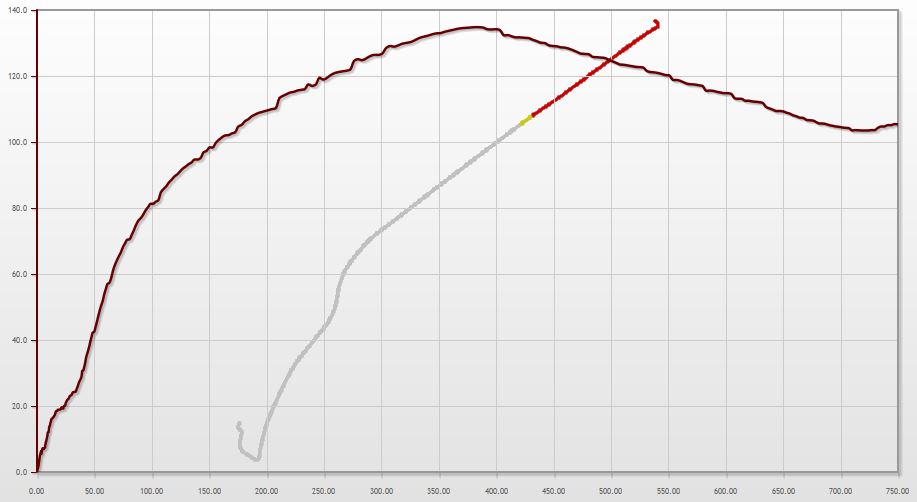

Please have a look at the second acceleration graph of the Porsche Turbo.
Speed isn't rising consistently as the car accelerates but rises, stays, rises again and so on.
This is (of course) not how my cars accelerate at all.

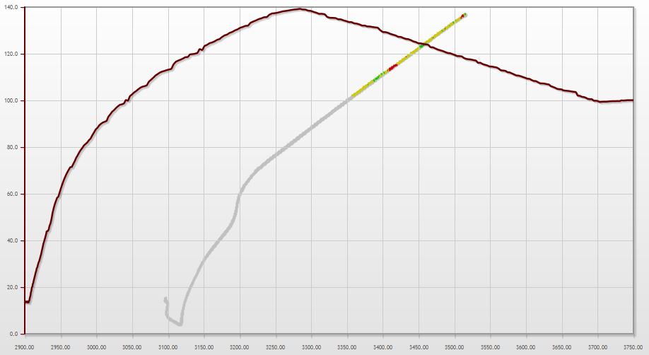

A different thought (#3): the graph looks pretty smooth, but speed comes in as 10 distinct values per second. I don't know which program you use to display the graph, but maybe this are some spline interpolations used by the viewer? Do you have a plot where we can see the discrete speed values?

Thought #3 was my first one as well.
As you can see the original screenshot from HLT shows the same behaviour. At first i thought it's a problem of bad GPS quality or dropouts but it's always there (I had 13 satellites and a perfect signal position-wise).
The graph section of born2race uses all the ticks' values in the graph. No further interpolation (if there are very few ticks the line isn't that smooth any more) is done.
