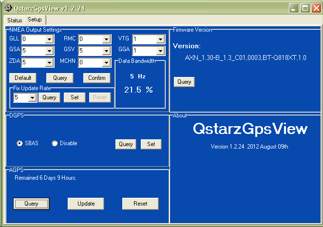

Yup no RMC... What do the numbers represent under each variable?
I had followed these settings from another website...

Re: Lean angle issue? Calibration / Landscape Orientation
The numbers are updates per second. Adding 5 everywhere will need too much bandwidth, so you need to keep some update rates low. I assume the Data Bandwidth is giving an indication on the share of bandwidth available is actually used. The lower, the better. The standard sets supported by LapTimer are:
#1 RMC (high) GGA (high) GSA (1) GSV (1)
and
#2 GGA (high) GSA (1) GSV (1) ZDA (1)
Where "high" is the highest number supported by the receiver (5 or 10 in your case). Set all sentences not listed to zero, they are not used at all.
Option #2 is the one generating the issues we discussed. #1 will work as expected.
and
