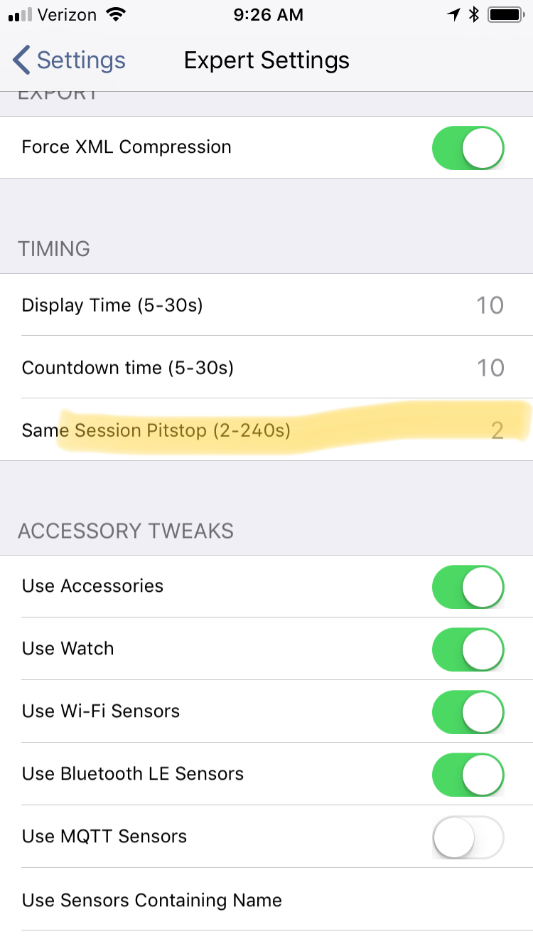

As far as custom setting the threshold, I'm not sure I'm seeing where to do that. I think it's this value, but I don't know what the numbers mean:
It says seconds and it's set to 2, this seems odd to me....So I don't think this is the correct setting, and I didn't see anything else in expert settings that read to me like a session boundary.

The setting is to tie laps into one session for cases in which there is a gap bigger than 0. So kind of your requirement the other way around.

Harry wrote:The setting is to tie laps into one session for cases in which there is a gap bigger than 0. So kind of your requirement the other way around.
Oh I see, so this is when the end of a lap happens, but the start happens a while later, I'm not sure I understand how that would ever happen since don't those always occur at the same point on the track? (ideally start finish). So it looks like there's no way to address either of the issues I'm having apart from trying to remember to hit the stop button on the phone during drivers changes, which we got right for 7 of the 8 changes over the weekend.
