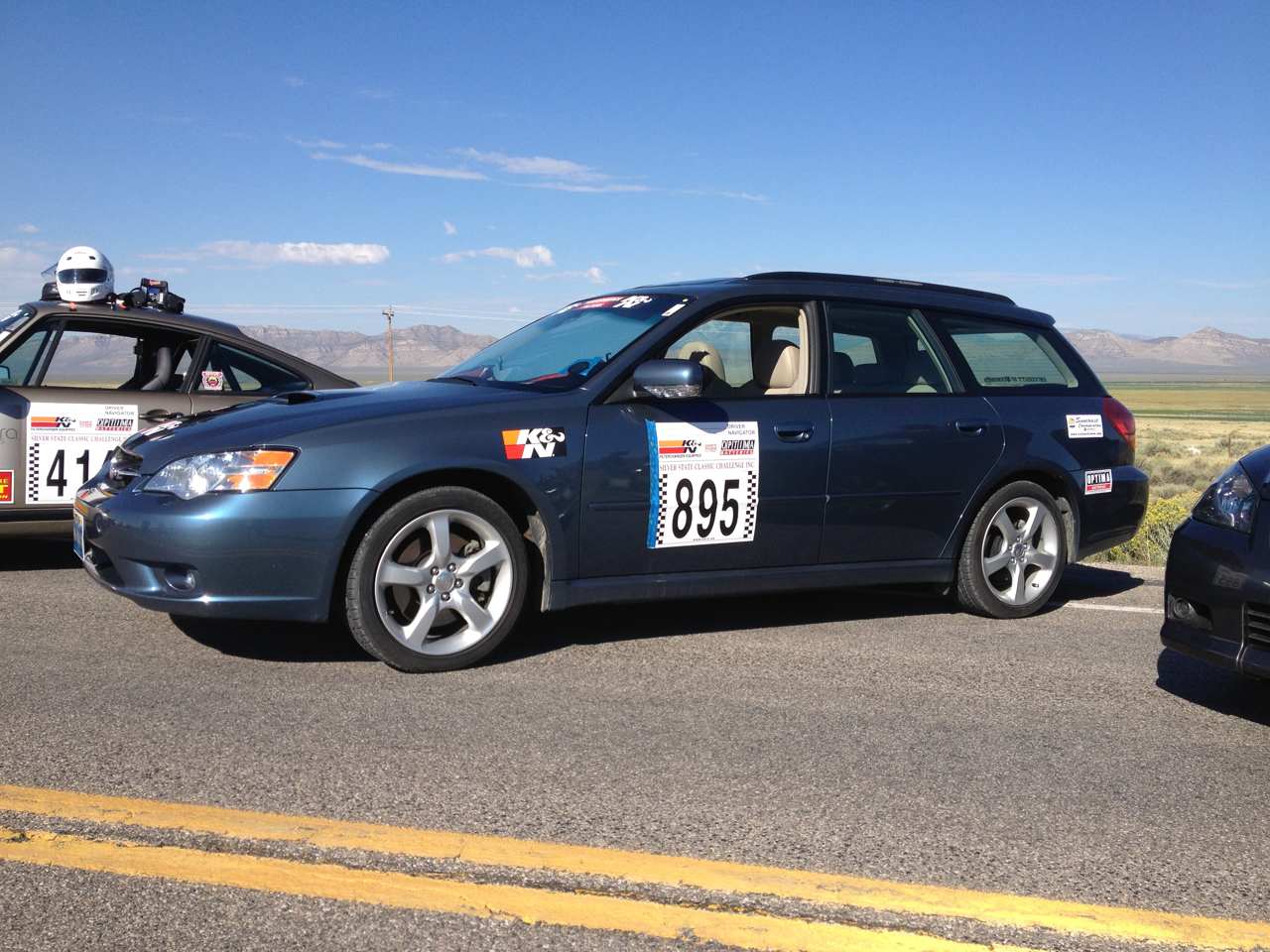

The attached photos show my car and how I configured the cockpit. iPhone 4s, iPad, XPS150, and a GoPro Hero 3. More on these in a moment.
So I decided to try to configure HLT to be my navigator. Here's what I found.

- SSCC13_1298.jpg (137.66 KiB) Viewed 7538 times
- Cockpit.jpg (197.36 KiB) Viewed 7538 times

Pretty impressive arrangement
