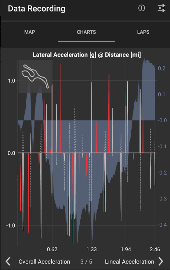

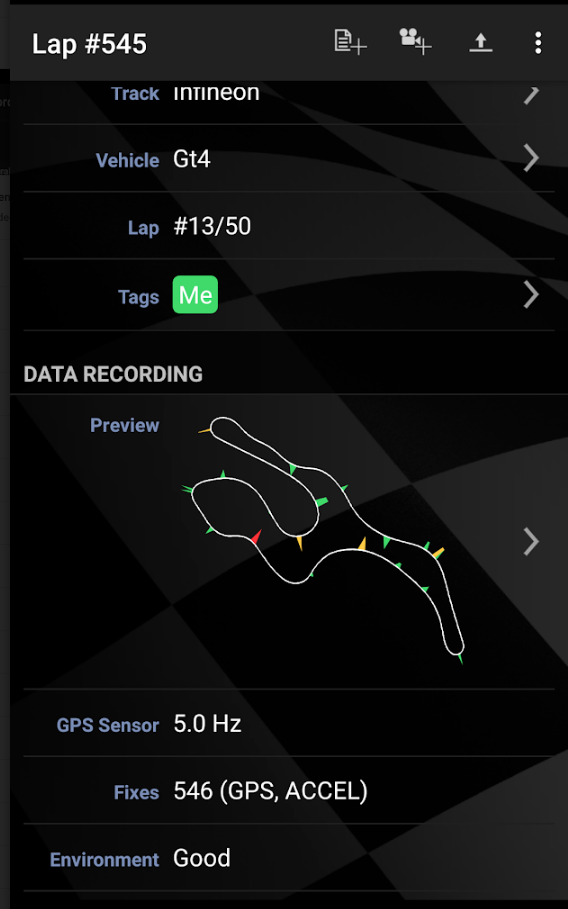

Hi!
When using Harry's Lap Time Petrolhead version 21.2 on a Pixel 2 with an external GPS (XGPS-160), the accelerometer data is faulty and looks like the screenshot below.
When I don't use the XGPS-160 with my Pixel 2, the accelerometer data looks fine.
I have used Harry's Lap Timer on a Moto X phone (2014) with the XGPS-160 and the accelerometer data looked fine.
Thanks for the help!
Screen Shot 2018-05-28 at 12.33.22 AM.png (171.64 KiB) Viewed 1922 times
Screen Shot 2018-05-28 at 12.33.35 AM.png (143.52 KiB) Viewed 1922 times

We have a thread on this topic already. For now, please recalculate acceleration:
  • Analysis ‣ Lap List ‣ a lap ‣ Recalculate / Acceleration
This problem will be addressed during LapTimer v22 beta.
