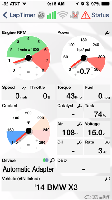

Hello all. New to this and needing some help:
No issues connecting to Automatic Gen II to HLT. But when I open up the engine fuction in HLT, there are no throttle, coolant, oil reading. Also, the engine RPM reading has a second or two delay, is this normal? Vehicle is a 2014 BMW X3. Thank you.

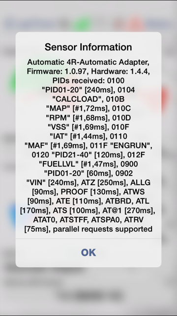

The delay will be around a second, that's latency from the OBD Gateway. To check what is going on with the other values, please post these snapshots: Sensor List with Automatic connected (and engine running). Then, select the Automatic adapter and create another snapshot (in case you see an Info button, press it before creating the second snapshot).

Are these the screen shots you need? Thank you.
Re: Automatic Gen II, HLT (GP Edition)
Yes, that's what we need...
Firstly, please update to the latest Automatic firmware, 1.0.99 is available.
Not sure it is due to the firmware or your car, but at least the above Sensor Information shows the X3 doesn't make coolant / oil temperature available, neither does it offer any of the throttle options. I'd suggest you create a new snapshot once you are on 1.0.99 and we can see if it is possible to at last get throttle.
I hope BMW has not reduced their already "short" support for OBD parameters. Car companies tend to consider bus information a differentiator they want to keep private (or use it as a competitive advantage). BMW has started their own closed smartphone strategy, that's probably a bad move for BMW drivers...
