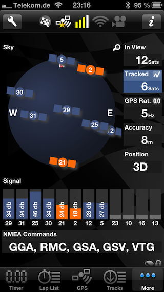

I also only ever get 3.9hz with the Dual XGPS, as reported in lap timer. Is there anything to do about this? I'm running the most recent firmware, and I have tried this on a couple of devices to ensure it isn't a setting problem on my device. I get 3.9Hz on all.
Any ideas?
Re: XGPS150 5 Hz update.
Please test your update rates again once v17 is available. I just tested the Dual and receive solid 5 Hz (even when increasing precision to one decimal digit.
